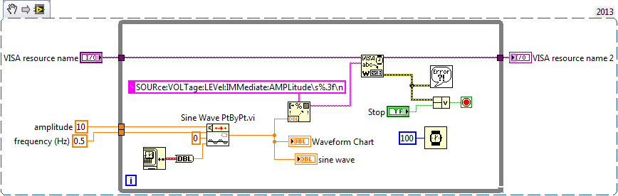

I am assuming you are talking about a programmable DC supply.
On an Non-Real Time operating system (like Windows), you will be limited on how fast you can go.
If you need faster, you need to get an AC power supply or an arbitrary waveform generator.
