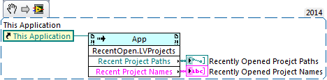

You can get recently opened project through VI Server with full path.
