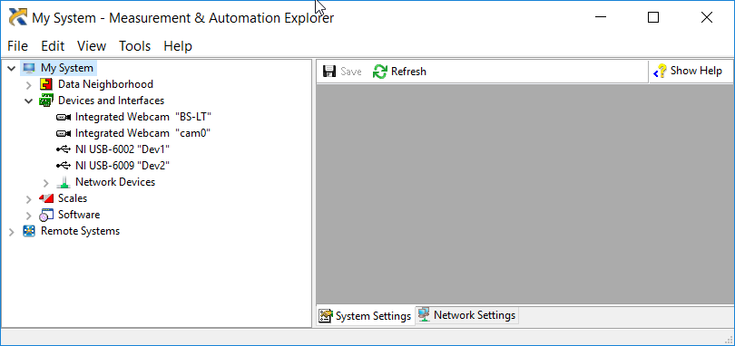

One thing that seems to be (in my hands, anyway) critical is that both LabVIEW 2016 and LabVIEW 2017 run fine on my PC if they are the only version installed, but LabVIEW 2017 installed "on top of" LabVIEW 2016 causes MAX to fail.  Indeed, even when I installed LabVIEW 2017 solo on this PC, MAX wasn't quite right, as shown below.

This, incidentally, is what MAX shows on my Laptop after installing LabVIEW 2017 alone (having done as complete an uninstall of LabVIEW as practical, including deleting all LabVIEW folders from Program Files, Program Files (x86), and Program Data).  Note that it shows both a USB 6002, with its proper Driver, and my Laptop's Camera (I installed the Vision Acquisition drivers), but the pane on the right doesn't show anything.  On the "Bad MAX" (seen on the 2016+2017 install), the pane on the right showed some information + an error message about a timeout, but the Devices didn't show the Cameras, and the USB 6002 driver never loaded, leaving it with a VISA designation.
