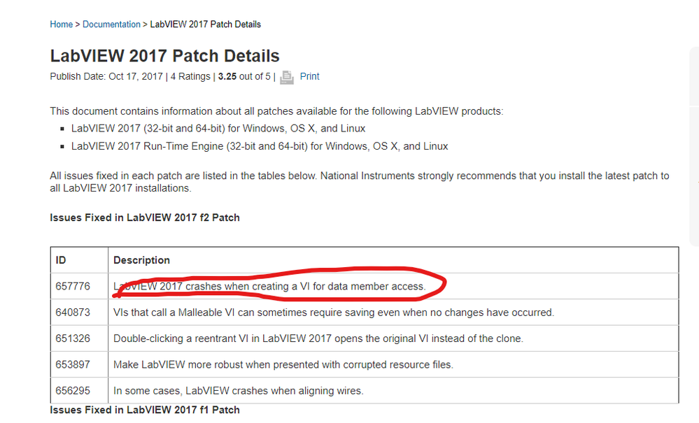

I have fixed the issue. Lucky, I found the update info on NI update about 2017. And the first item is about this.
