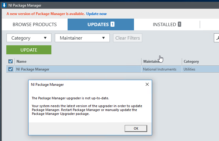

What version of Package Manager are you using? You should be able to update NI Package Manager through Package Manager. If the Package Manager feed is registered (which it is by default), any new versions should show up as an update. Depending on which version of NIPM you are using, you may even see a banner along the top notifying you that there is an update for NIPM.
If you go to the updates tab, and try to upgrade it, likely you will be greeted with the error shown below:
As the error indicates, you should be able to close and reopen Package Manager which will upgrade the Package Manager Upgrader package. Once it gets upgraded, you then can upgrade Package Manager using the banner or the item in the Updates tab. This is the easiest way to Upgrade NIPM.

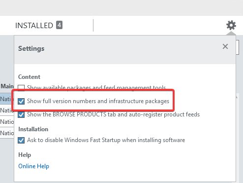

Alternatively, you can manually upgrade that package. To do this, you'll need to first ensure the "Show full version and infrastructure packages" checkbox is checked. This checkbox can be found by opening the settings by clicking the cog in the upper-right.
Once that checkbox is checked, you should now see the NI Package Manager Upgrader item in the Updates tab. Upgrade just this item, and once upgraded, you should then be able to upgrade NIPM.

thank you all for your answers unfortunately I didn't receave them until now (don't know why..) and concerning your question : no i doesn't solve the issue when I relaunch NIPM I just get the same error (the error that Brandon showd in his Post)
and when I click on NI Package Manager Upgrader item in the Updates i also get an error saying that the Package Manager is too old
