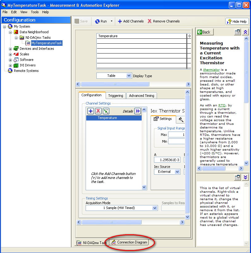

Gorman,
Looks like you did get all the steps right.  The connection diagram tab is located at the bottom of the window.  This screenshot should help.

Is it possible that older versions of MAX do not have this feature ?  I have version 3.0.1.3005.  I recreated the task and included a snapshot of what I see.  (Sorry, no software to make the image more presentable)  Maybe the feature is locked somewhere or my MAX version is too old.  Thanks again to everyone for all of your help.
Message 7 of 8
(6,160 Views)
It does look like the version of Measurement and Automation Explorer (MAX) that you have does not have the connection diagram feature with it.  This might have been added in a more recent version of Measurement and Automation Explorer.  If you want, you could upgrade your version of DAQmx and there fore the version of MAX as well.  However since you have LabVIEW version 7.0, you would have to use DAQmx 8.0, which I am assuming, you are already using.  All later versions of DAQmx will work only with LabVIEW version 7.1 and above.
