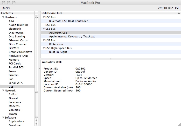

So I am better able to answer their questions, would you mind answering these questions below about your setup:
1) What version of OS X are you using (i.e. 10.5)?
2) What type of Mac do you have (i.e. Macbook Pro)?
3) Is the third party sound device the usb one or how is it plugged into your computer?
4) Could you post a screenshot of what the System Profiler says about the third-party sound device so I can see how it shows up?

3) The third party device is plugged in via USB and under the system profiler can be found under USB devices. From experiences it would be under the corresponding device, say if it were a PCI Express card, then you'd see it under PCI cards.
4) I've attached a photo of the system profiler's Sound Device data.
5) I am using LabVIEW 2009 Student Edition, purchased this term.
