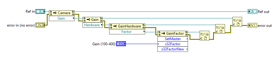

I am using a Thorlabs DCC3260M Monochrome Camera. I admit I am not great with .net . I am trying to figure out how to set the gain. I can get a property node to show a "gain" property. But it gives (or wants the input of) a reference. I am not finding the way to connect this to a front panel object. I included a screen shot of a portion of their "simple live.vi" which as it suggests is a simple quick start for acquisition. It does everything else like frame rate etc...
How do I get a front panel slider connected to the .net functions so i can set the gain?

If it's like the UC480, you have to drop a couple more property nodes to get at the actual gain setting. Like this:

Yes, this is exactly it. For posterity, do this after the camera is initialized, put the code he shows here into the live acquisition loop. Works great.
