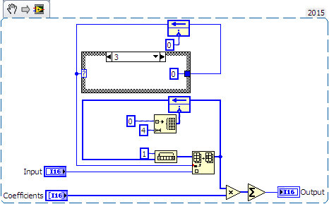

Maybe this will be better, although I question the efficiency of the "Rotate 1D Array" primitive.....
PS. is this for a Windows, RT or FPGA target?
