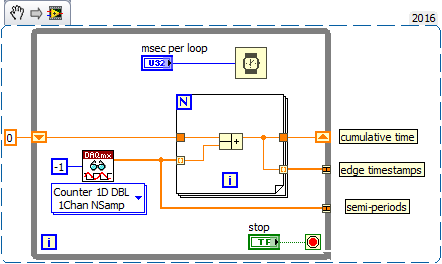

Most of what you want to do is likely quite possible, but you need a better understanding of the distinction between signal timing measurements with a counter task, the background buffering of those measurements via the DAQmx driver, the retrieval of those measurements from the buffer via calls to DAQmx Read.vi, and the software timing of the loop iterations where you do these reads.
Semi-period measurement will likely be your best bet for both precise interval measurements and max positional resolution.  I can't look at the code now as I don't have a new enough version of LV here.
The measurement data holds the important timing information -- no need for fast loops or the High Res Rel Secs function.  Just take the semi-period and perform a cumulative summation of the interval times to get an array of "timestamps" corresponding to each edge of one channel of an encoder.   See the snippet below as an (incomplete) illustration.
What DAQ device are you using for this?  There's a particular issue that affects newer boards based on the STC3 timing chip, such as the X-series MIO boards.  With such devices, the period measurements won't start at the time of the triggering signal, they'll start at the 1st encoder edge *after* the triggering signal.  Thus the t=0 point for one encoder may not match the t=0 point for the other encoder despite the effort to properly configure the Arm Start trigger.
(Note: there's a pretty effective workaround, but it's more complicated conceptually.  I plan to followup on the idea exchange with more description when I get around to it.)
-Kevin P
