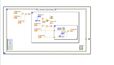

Hi guys,
Sorry for the misleading information, I have tried to finish what I talked about last week but still couldn't able to do it..
I will repeat the problem again: my problem is that how could I able to add a delay after the first value of each iteration except for the first iteration? Basically, the delays start from the second iteration of the FOR loop.
Really sorry for the misleading information on the forum, it's a mess...

Hi AIEXINUK,
no wait in the first iteration, but later on?

Did you try the suggestions about using a Select function or Case structure?
"But what I'd like to see is that after the first iteration of the inner loop which is the minimum value of D, the program waits for 1s."
If i = 0
  wait (0)
else
  wait (1000)
aputman

Thanks for your reply.
This is a good idea that @aputman discussed this last week.
But this will delay every value later on. While I'd like to delay only the first value in each iteration which is tricky and hard to me(except the first iteration)
Like the graph I attached below, if I set D maximum to 50, D minimum to 30, step size to 10, while V max to 1, V min to 0.5, so the delay only happens when the D minimum is 30 (1 sec) except in the first iteration. For now, the delay is only triggered by the 'wait until next multiple'.
Message 17 of 33
(2,813 Views)
You have to take that Wait until next ms out of the inner FOR loop.
Message 18 of 33
(2,807 Views)
If I do so, I won't be able to see the change of D.
Message 19 of 33
(2,791 Views)
OK, it's hard to see in your image but I think that you've got your logic backwards. You want to have your wait time if i=0 and otherwise have it 0.
Message 20 of 33
