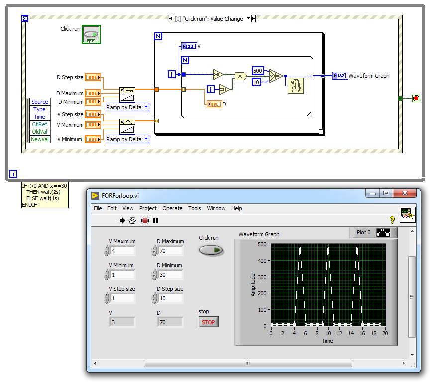

Hi AIEXINUK,
So now it would be 30,1sec, 40,1sec, 50,1sec, 60,1sec, 70,1sec, 30,2sec, 40,1sec, 50,1sec, 60,1sec......
You really need to learn how to express simple logic dependencies!
You already learned about the Select function in previous posts.
So I guess a simple hint is enough for now:
IF i>0 AND x==30
   THEN wait(2s)
   ELSE wait(1s)
ENDIF
"i" is the iterator of the outer FOR loop…

Additional hint - this logic has to be in the inner loop.

Hi AIEXINUK,
If I type the values in the front panel, sometimes it will have a 2sec delay when it reaches the minimum,
Please define "sometimes"…
The code runs fine for me (you should have learned about the Ramp function until now):
The longer wait occurs not in the first iteration of the outer loop…

Change your logic just a bit. You really want x==Dmin. This only occurs when i=0 on the inner loop. Also, you should be using the Wait (ms) function, not the Wait until next ms Multiple function. Finally, change the datatype for your wait times to U32 to match what is expected by the Wait function.
