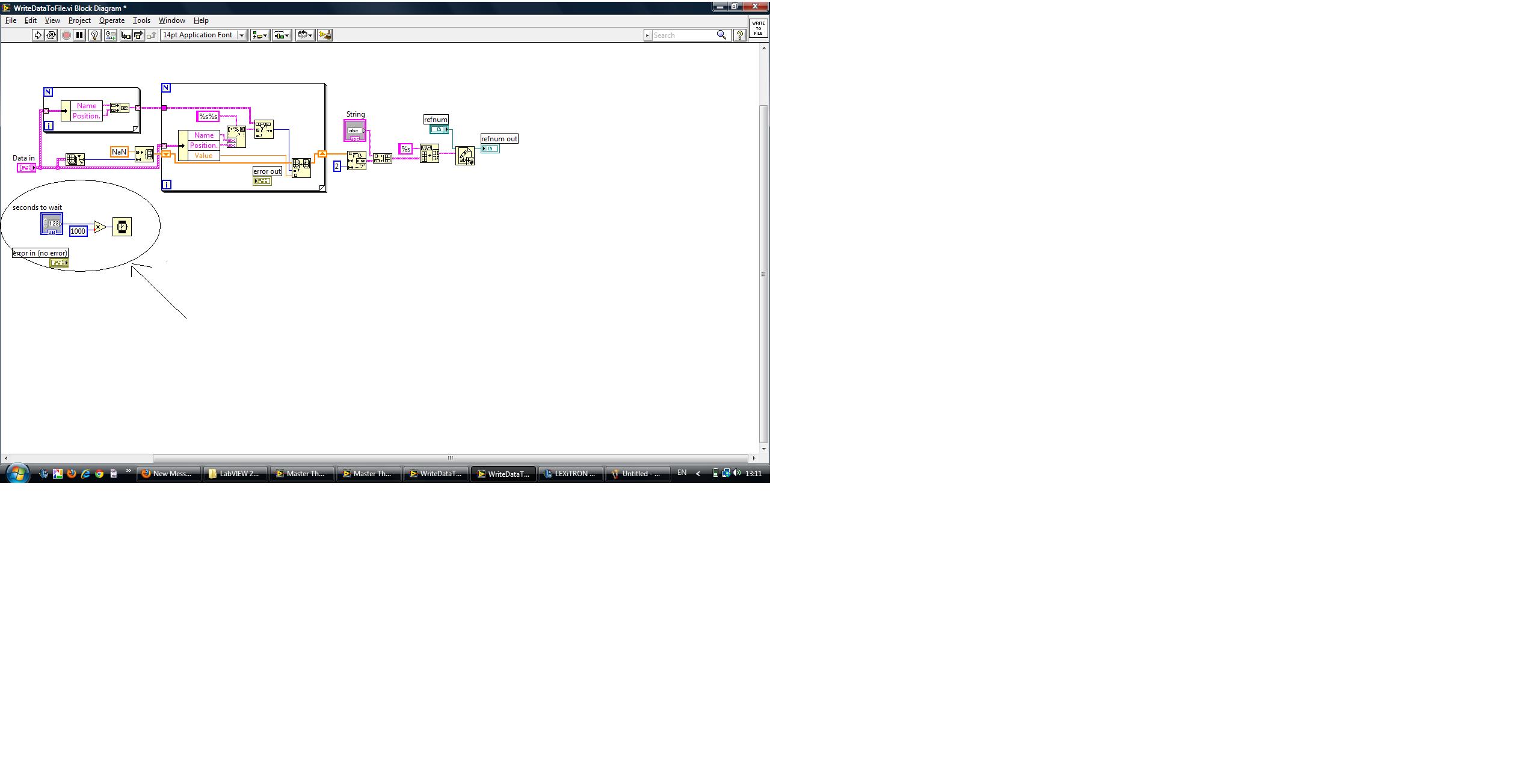

Hello, I got a problem with time delay of the data writing into file. It also delays the data acquisition which I don't want. As you can see in my VI, I put the time delay only in the sub VI of writing data into file. However, it also retards the whole program. I want my DAQ to run at the normal speed but the data to be saved every 1s. If I remove the time delay of saving data, there will be too much data in the file. What should I change the time function? It might be the consequence of the position of the time block function.

It is because the file save subVI is dertermining the loop speed.  Look into the Producer-Consumer architecture.  Basicly, your acquire and log need to be in separate loops.  Send your acquired data to the log code using a queue.

as crossrulz said, Ive used the producer/consumer architecture for this purpose very successfully, One loop getting data then one displaying then saving to tdms. Working like a dream.

what should happen is you create a queue. Set up 2  independant while loops one above the other on the screen. In the top loop have your data capture, put the data on the queue. then in bottom loop put your save to file (or whatever you want to do with the data. (dequeue data, process). The loops will run independantly of each other ad infinitum so you will need a stop mechanism of some sort. Best bet is look at examples and work out how they work.
