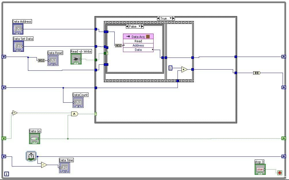

The relevant part of the FPGA VI is here: http://i167.photobucket.com/albums/u142/rurwin/MemRead.jpg

I've just increased the FPGA clock speed to 80MHz from 40MHz. The maximum delay reduces to 10us, the minimum and average delays are unchanged.
In the VI you will see that Data Read and Data Count are on the input side of the FIFOs. This is a recent change to see if it made any difference to this problem. It didn't. Previously they were in a similar position on the output side. The Data Time indicator is unused; in its current form it doesn't measure anything useful.
