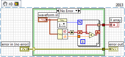

That would be because you write 10 copies of t0 to the spreadsheet
Try this little maodification and see if that helpsSmiley Wink

Thank you, Jeff! That did it. I understand now that t0 is the first value for every group of data I sampled, and that I should not have assumed the value to increment on its own.
I achieved similar results using the Get Waveform Time Array vi as well.
Glad to help!  (Take a wild guess what the BD of Get Waveform time array.vi looks like)
Thank you! That makes perfect sense!
One of my "favotite - all time" kudos-  now guess which code is more effecient!  (For the specific case--- in the general case the code you found has advantages)
