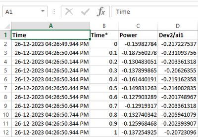

I have attached the VI and the pattern of .TDMS file that I need for your reference. Requesting someone to help me on this topic. DAQ-Only.PNGDAQ-Only.PNG

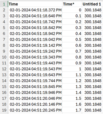

Thank You GerdW,
When I tried to keep all initialization code before the loop, the DAQmx start function returns an error message. However I tried to reduce the complexity of my code and followed other points suggested and almost arrived at the solution. But as you can see in the attached snippet of the file that was written the absolute time values aren't precise at milli second levels. Requesting you to help me with that.

The best would be to share your updated code.
CLA
