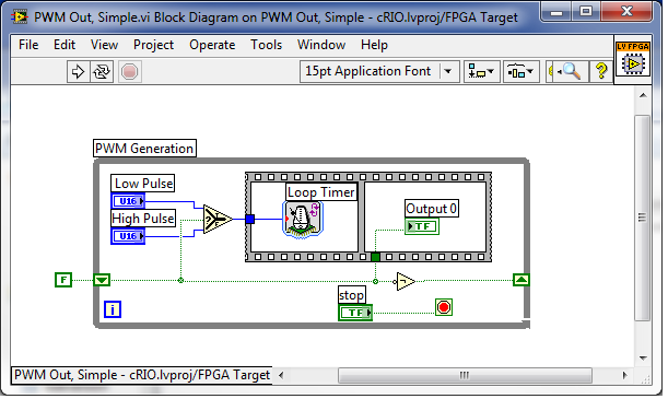

There are many different ways to accomplish a PWM on a crio, but the simplest way is to use a loop timer. Please look at the "PWM Out, Simple - cRIO" example in the Examples Finder. I have attached the main program to give you a previes.
(2,960 Views)
Thanks for the response. The example looks pretty similar to my FPGApwm vi. The timers work, but it seems like the cycles of the while loop as a whole have inconsistent timing. Something is happening to make the light pulse inconsistently.
(2,955 Views)
You should really be using a timed loop for your FPGA code. Depending on your clock speed, you are probably hitting the limit of while loops with delays. Please check out this whitepaper from NI [broken link removed].
(2,953 Views)
My problem with using a timed loop was that I couldn't write to my digital node in it. What is the best way to go about doing that?
