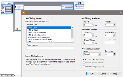

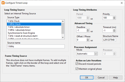

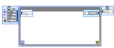

1. Initial:AshwiniWini_0-1672813278320.png
2. Changing Configuration: AshwiniWini_1-1672813308480.png
3. After updating Configuration: AshwiniWini_2-1672813333686.png
What would be the reason. Is it possible if some NI Package or Software which is not installed correctly, which could cause this issue.
Has anyone came across this error. Which software/package should i reinstall to fix this issue.

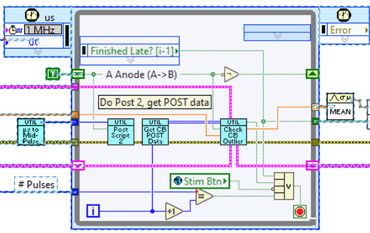

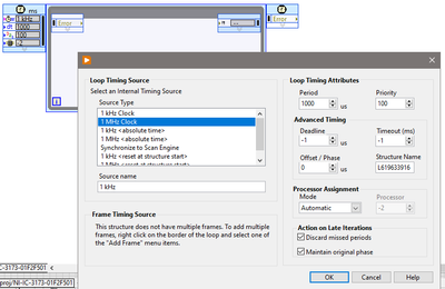

The Timed Loop comes into its own when placed where it belongs, inside code running on in a LabVIEW Real-Time environment.  From what I can gather on the Web, the NI IC-3173 can (and, in my opinion, should) run NI Linux Real-Time, and in this environment, you should find that it is configurable.  I've attached a screen shot of a Timed Loop in a LabVIEW RT Project in development, as well as a screen shot of one of the Timed Loops "in action".  You can see that even though there is no "hardware" attached to my laptop, because the Timed Loop is in a VI located on the Real-Time Target, LabVIEW lets me configure it with all of the Timing Sources.  One of the loops is also illustrated.  This is controlling a low-frequency Pulse Generator generating alternating positive and negative pulses (controlled by Boolean "A Anode (A->B)").  Note that there are four conditions for ending the loop:
  1. The # Pulses requested have been produced.  [This is the "good" exit condition].
  2. The previous loop took too long to finish, so this loop was "Late".
  3. Data acquired during the Pulse determined that the Pulse was an "Outlier", wrong size.
  4. A "manual control" ("Stim Btn") signal requested an immediate Stop.
So I still don't know what you are trying to do with a Timed Loop (because you've not shown it to me in context with the LabVIEW Project in which you are trying to use it).  You do appear to be running in the LabVIEW Real-Time environment (according to what I see when I open the Project).  I don't have experience with NI's Industrial Controllers, and don't have the drivers installed on my system (I don't even know what to look for, as I have little documentation on this now unavailable-for-purchase hardware).

Thing is i am not able to change the Loop Timing source of Timed Loop on any target, whether its Windows or IC target. Whenever i select any Timing source (Same or different source), everything goes to zero as shown in my first video.
It seems an issue with my software. As timed Loop is part of LabVIEW, may be reinstallation could help.
