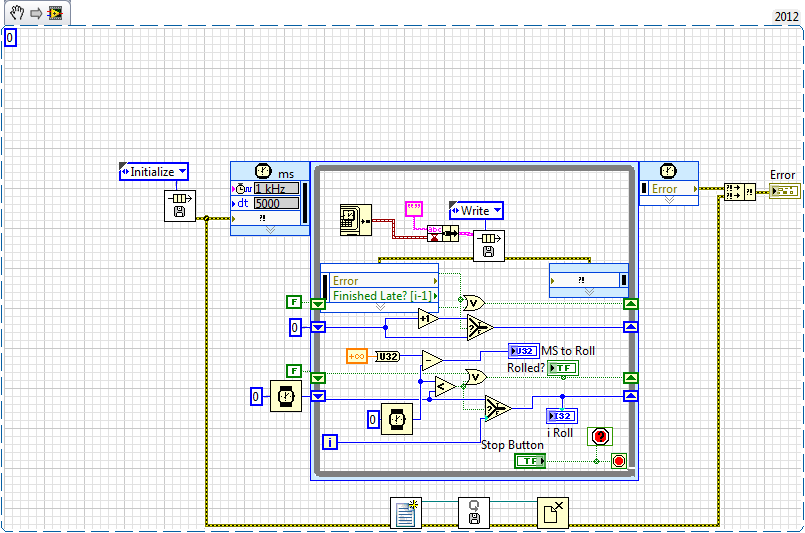

I just whipped up a vi I'll run in a week or so and see if I can duplicate but it will take some time i'm 11 days to rollover
No I won't post the source I hacked at the OPs stuff without renaming and he would justifiably harm me.
