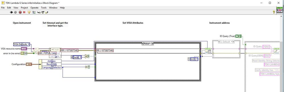

I have explored and I see the error happening here:
So the error happens at VISA read.

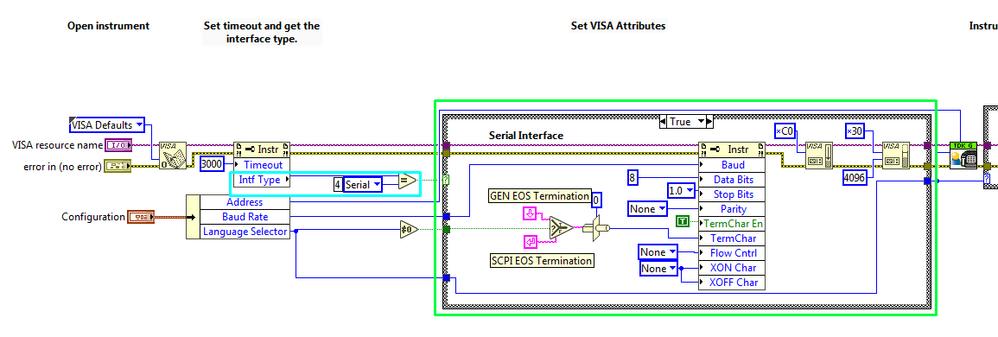

Okay, so I have fixed this particular error, and I will provide a solution here, in case someone else runs into this problem. In the example sketch it failed in "initialize" field. What has to be done is Ctrl+click on "initialize" block, and configure the blocks provided. What I did not realize, and what was not documented, was that they have to be changed according to the interface you are using. In my case it was serial interface, and my port configurations came from the power supply's datasheet. I do not know what are VISA default settings. The tool for configuring these "loaded settings" is NI Measurement & Automation explorer (for Windows). Below the pictures are added, since they speak more than words.

That sounds like a poorly written driver.
What happens when you need to use this on another PC?  You'll have the same problem and need to modify the settings again.
The correct solution is to use a VISA Serial Configure subVI write before the first subVI from this driver kit.

Hello Atizss,
+1 for RavenFan's posting. I have not looked into that driver, but deducing from your postings the VISA Configure Serial Port vi is missing. It allows to do the settings you MAX panel shows among others.
