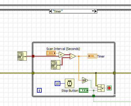

But in general I do timers like this: Notice it is also a "Timer" state in a state machine.
DON'T FORGET the "wait mS" vi giving the loop a 10mS delay.
This prevents Windows from using 100% of the CPU to spin that loop as fast as it can.
