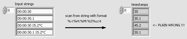

Not sure this has been reported before, but it certainly is a bug... It looks like if, when Scan From String is configured to read timestamps with fractional seconds but only find integer seconds format, it takes any following number it can find and adds it as full seconds to the previous scan it got ?! Certainly wrong !

This is undesirable behavior, but I don't know if I would technically call it a bug.
Your format string tells the parser to find a fractional part that does not exist in your third string.
If the string is 00:00:30.0 then it should parse correctly. The content of the strings is inconsistent, which is a problem with the source of the data.

Hello Sci-Vi!
The behavior of the function is correct in this case. %u in the time format specifier handles both the digits before the decimal point as well as the ones after. In the example 00:00:30 15.2°C using %S%u means the function first finds 30 and additionally 15.2. Since both are the values for the seconds in the timestamp they are added together.
The correct format specifier is %<%H:%M:%u>t which returns the correct value for all the examples in your post.

I indeed also noticed the localization problem for timestamp scans from string, though not knowing there's been a CAR for so long about that...
Now I only partly agree with your comment. Yes you're right, the format string precisely describes a very specific format, and the input string generating the problem can be considered as not strictly corresponding to that format description (no fractional part). However, in this case I would expect:
- an error to be generated (it is not the case here), just like when any other scan from string meets an unexpected format
- at least the next number to be considered as the fractional part of seconds, not as full seconds to be added to the previously scanned number
Note that the error handling of timestamp scans is lacking in much more general cases, as I have noted in another related post.

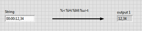

Hello Gerd,
I understand that the LabVIEW help is confusing regarding %u in timestamp specifiers.
However, I cannot reproduce the behavior you describe: "When using %u to convert a timestamp to string it also only outputs ".123" with no leading numbers for the fractional seconds part."
See my output below: (I am using a German OS, so the decimal separator is a comma)
  Georg
