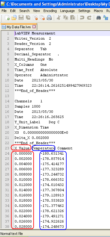

I tried running the second loop (section) with a simulated DAQ device, and attached is the output file... it has the Timestamp column.. and yes Timestamp means to have time column (not necessarily column, just starting time and sample rate will also do)...!!
Output Data (LVM) File

The second file attached is the output LVM file from the "Write to measurement" which I am getting. I wish to have a time column from 0.000 till the end. (Just like the Temperature loop)
I hope this makes sense now. 😕

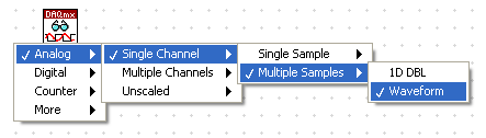

Chnage the DAQmx Read.vi to acquire "Waveform" instead of "1-D Array"..!!
Waveform preserves the timestamp info with each sample it acquires, which you're missing when set DAQmx Read.vi to acquire "1D DBL".
