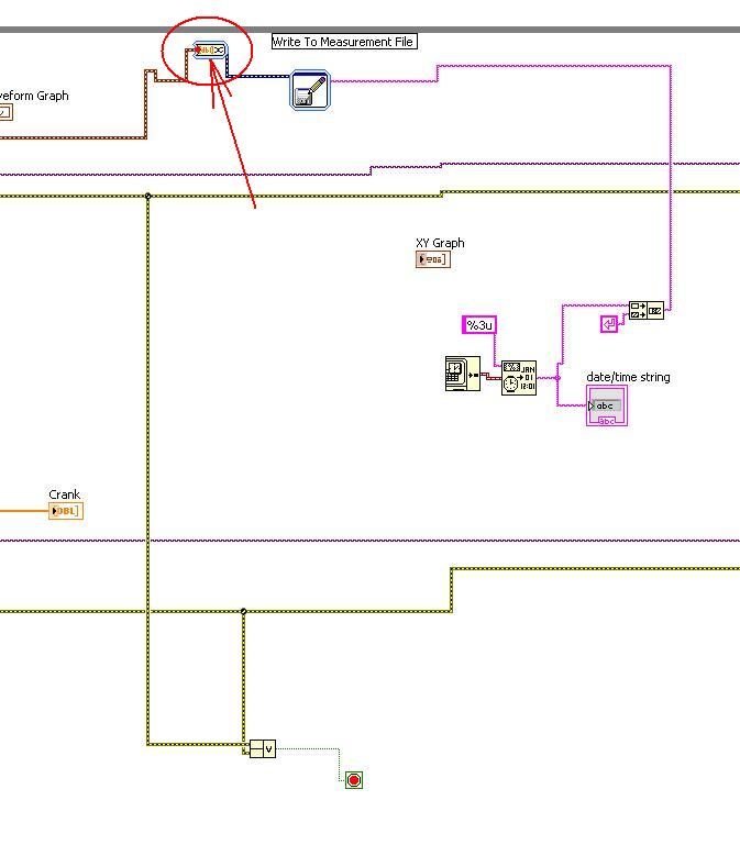

Please have a look at the following snapshots.
Message 13 of 17
(1,577 Views)
Here is the issue...!!
Spoiler

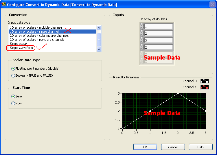

Either delete it OR double click and change the configuration as shown below...!!
Spoiler
Hope this is the solution...!!

Thanks, I suppose it did work.
But, the output(Time column) seems a bit wierd. I am rotating the encoder at around 50 rpm. And this is the output that I am getting. Shouldn't I be getting it in appropriate single digit seconds?
Your method did work. But do you know what is the problem? I am trying to troubleshoot my vi if it is working the way I need it to be.
I wish to have a pressure sensor triggered every z index pulse by the encoder. I am missing out alternate z index by acquiring 2000 samples (Encoder has 1000pulses per rev)
