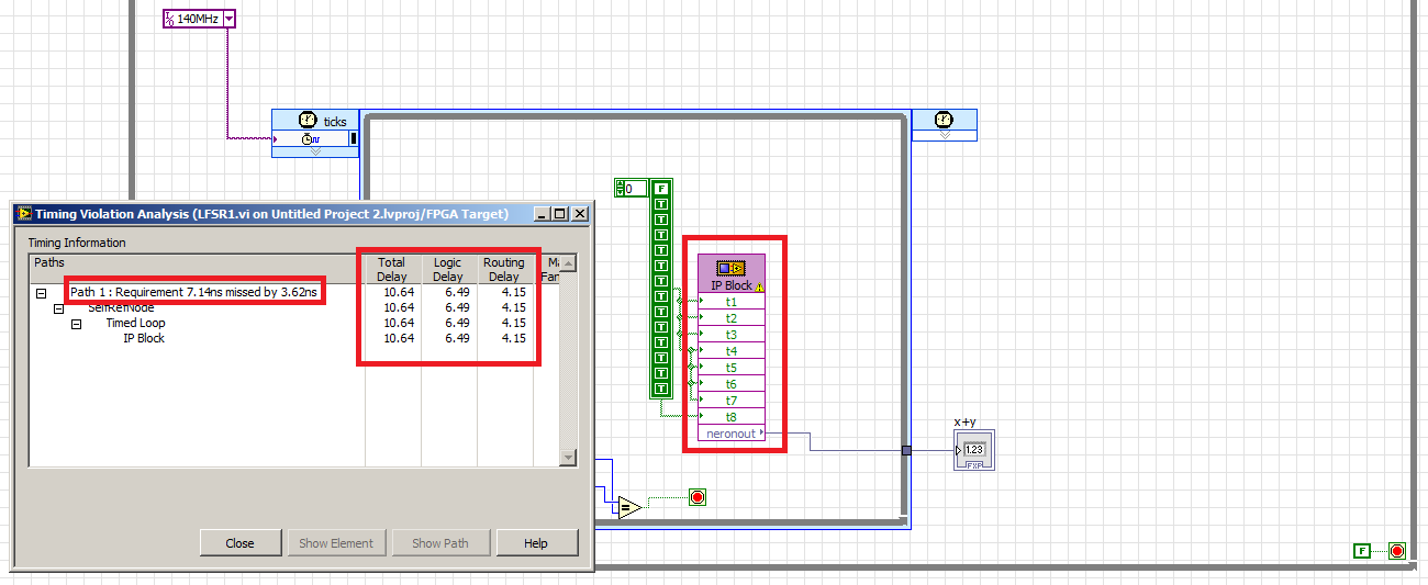

in figure below you can see an time violation was happen in my IP integration
the problem is how to calculate the maximum frequency from the numbers appeared in red block ???
I try  to connect 150MHZ,140MHZ  time violation also appear !!!!
What is maximum working frequency for this IP block ??

The timing violation dialog is telling you that your logic needs 10.64 ns to operate. If you invert that, you get a clock route of approximately 90 MHz. So you can change your clock rate to that or you can try rewriting your code to require less time. Since a large portion of your time is in routing logic, you might want to try pipelining your design or rewriting it to require less fanout on signals.
Thank you
I try  to use 100MHZ and no timing violation dialog appear..........!! And  timing violation dialog say (inverse of 10.64ns) must use 90MHZ approximately I am confuse now
Is their any wrong???!!!
Use 90MHZ or 100MHZ???
Finally what is the difference between logic delay and routing delay
as I understand the routing delay is the combinational path delay between two registers
what about logic delay???
best regards
hi ?Q>
Message 3 of 9
(5,983 Views)
Accepted by topic author mangood
Logic delay is the delay through the actual lookup tables, DSP blocks, etc. The routing delay is the delay between the "real" logic; the delay between the logic blocks including the time to go through the switching matrix. You generally cannot decrease the logic delay without rewriting your algorithm, but you can decrease routing delay by inserting registers to help let the tools move logic around on the chip.
And you have stumbled upon one of the great mysteries of using an FPGA. Sometimes changing the clock rate just a little can cause the tools to generate different code that performs better. In your case, it sounds like the tool could do better and hit 100 MHz. With your original 140+ MHz the tool figured out early on it couldn't hit that rate so it stopped early before doing any further optimizations thus showing you it guessed it could only do around 90 MHz.
