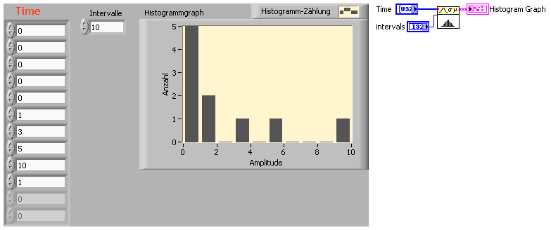

Hi aneps,
did you ever had a look at the Mathematics->Probability function palette? There are ready-to-use functions which provide histograms:

@aneps wrote:
The files are attacted here... the first one "RAE.vi" is my original program. It has some drives which may not be shown when open in any other computer because these are the drives of specific cards I use (CAEN cards). In this, you can see a "Time" array. This is the array which I want to input to a histrogram and display while running.
What is the typical range of times in the array? If it is just 0..10 as in your example, all you need a very simple code. No histogram subVI needed.
