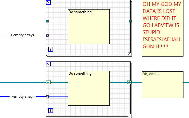

One more common mistake... My very personal memory (luckily, without the red colored text) Cat Embarassed
Generally, shift register are often misunderstood.

Yeah, I think all of us who have been using LabVIEW for more than a few years have ran into this problem, usually self-inflicting.  I sure remember when I found that in my code.

The following is somewhat off topic...sorry...
I actually have this as an interview question. Notice the for loop with the empty array. Gets um every time, although the clear errors and the split queue reference wire should be a hint...Smiley Very Happy
