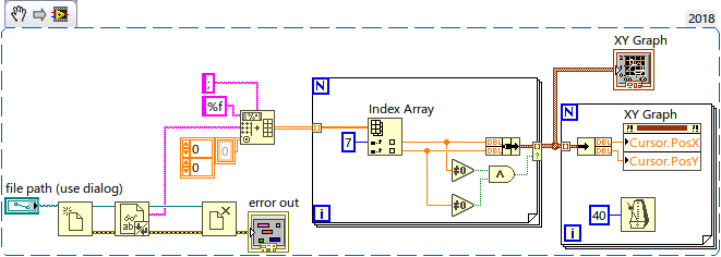

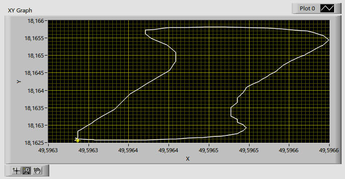

In general you're on the right way, just remove zeroes, then axis autoscale will show complete curve and create graph as shown below (outside of the loop):
Then it should work:
(if I understood your goal correctly)
(362 Views)
Thank you very much! That's exactly what i was looking for!
