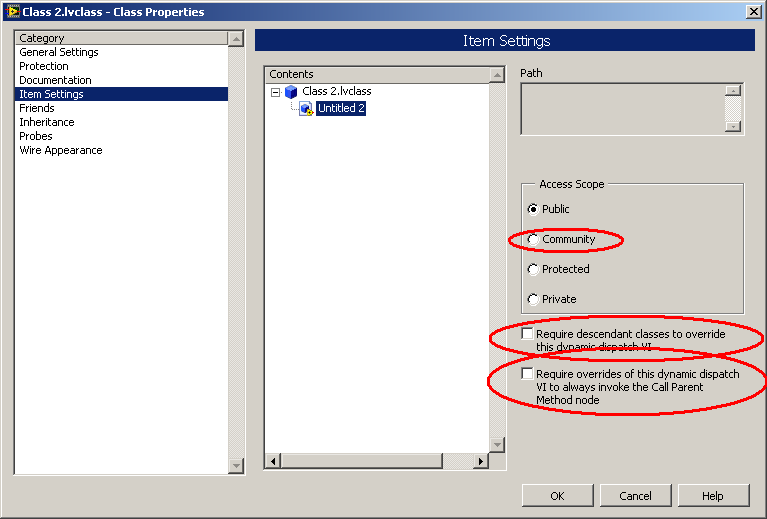

OK, I think we need a nugget on the new LVOOP capabilities.
I see we have two new very useful options for LVOOP.
1) Child classes MUST Override Dynamic dispatch VIs.  Settable per VI (Via Class properties). Cool.
2) Require overrides to call the parent method.  Settable per VI (Via Class properties.  I often thought this would be a great idea.  Excellent.
We also have the "Community" access scope which I'm sure will prove useful.
I still do not quite "get" the "Transfer Must Overrides" option though.  I see that it refers to the new "Must Override" option, but what exactly is to be transferred?  Does this force propagation of the Must Override all the way down the hierarchy ensuring that not only children but also grandchildren, great grandchildren and so on ALL override this VI?  If so, I feel "Propagate" would be a more intuitive word than "Transfer".
Shane.
