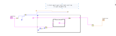

Awesome thank you! So I ended up trying a different approach to this (attached). Now my problem is I can't seem to get the right output but it may be because of my case structure. As well, for the message I switched it so that it isnt a,b,c etc but can be other characters. I have attached a screenshot as well as the VI that I am currently working on for this problem.
If you want more people to look at your VI, do a "save for previous" (2020 or below) before attaching. I currently cannot open it.
Form the picture, there is a lot of "code smell".
  • Apparently the problem has changed and now you have two characters per symbol.
  • The result must be an integer, not a floating point number. There should be nothing orange!
  • No matter what numeric output data type you pick, you'll quickly run out of bits for longer inputs. You cannot have a scalar numeric output for a general solution

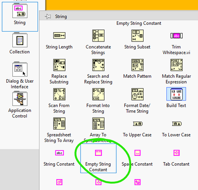

Hint for your problem:  Using two quotes that look like an empty string is NOT an empty string.  Erase them or use the empty string constant in the string palette.
