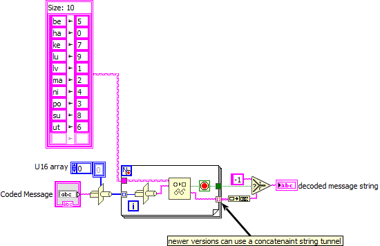

@altenbach wrote:
(And yes, you could create a map for even simpler code).
Here's how that could look like!
You can figure out how to create that map constant from the earlier array of clusters 😄 )

@altenbach wrote:
For a map with 10 elements, the difference between a plain search O(N) and a map O(logN) does not justify the map overhead. That only starts to matter for larger collections. A LUT is O(1) and the max size here is tiny (256 elements) that can be constant folded.
It's not just the size of the collection. It's also the number of times it's called.
For this homework assignment it's completely irrelevant, but still a fun topic.
