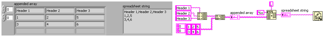

Accepted by MJ40
Something like this.

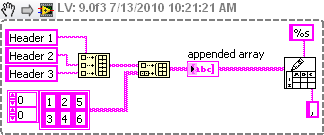

If you are going to use Write to Text File, you need to feed in a string, not an array.  This code will work:
18773iB4872BB7473FAC4C
As an alternative, you could use the Write to Spreadsheet File function instead of the Write to Text File.
18775i3EEBB9879A245DF7
- tbob

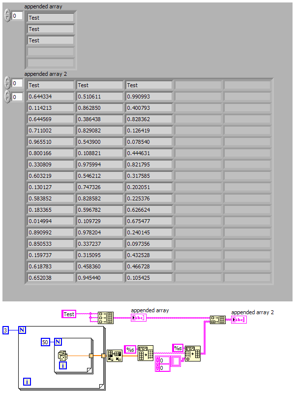

Thanks! I was able to fix the transpose problem.
However when my data is collected I have a strange offset. I tinkered with it and got some different excel output formats but not the one I want. Any ideas?
Code1 is the Code that gives the output to excel1.
Thanks.
Message 9 of 21
(11,383 Views)
Put a probe on your header array before it goes into the last build array.  Put a probe on your data also.  See what you have there.  Put probes on each input to the last build array, see what you have there.  Finally put a probe on the final array going into the File write.
