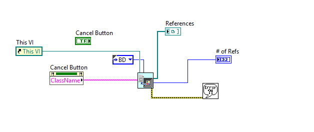

I wondered if anyone else has encountered this... It appears that Traverse for Refs no longer detects controls.
The attached example is written in 2017 and returns 0 refs.  I wired the class name directly, so no typos.  Try traversing for controls - nothing.  Try traversing for GObjects, you get a bunch of stuff but no controls....

Nevermind.  I figured it out.  If you want a reference to a control on the block diagram, you need to search for "ControlTerminal".  It's still confusing that the class name property outputs a class name, but it is not the correct class name to use with Traverse for Refs...

Click on the BD enum and change it to FP. I may not be getting the names completely right by a Control is only found on the front panel where as a ControlTerminal is only found on the block diagram. They are separate objects but you can get the reference of one from the other.
(3,028 Views)
Yeah the reason I had the BD selected is because I pulled this out of some code where I was looking for the controls (terminals) located inside a structure on the block diagram.  Could not figure out why it couldn't find them.  But I figured it all out now.  Using ControlTerminal instead of Control seems to work for that.
