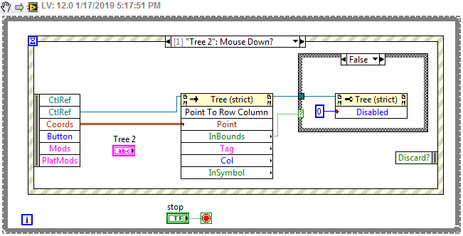

If the tree is always disabled, it should be fairly easy to do something like the attached.
Basically, the tree has a method that converts a mouse click to a row/column and will also tell if the mouse click is within the content rectangle of the tree.  If it's not, that means the mouse click occurred on the border of the tree or inside the scrollbar.  Either way, enable the tree for scrolling until the mouse goes back up.
If the tree is sometimes enabled and sometimes disabled as you say, you'll need to store the current disabled status and restore it on mouse up.  If it's already enabled, you don't want to disable it on mouse up.  I'll leave that for you to figure out.

Thanks Aputman!
Exactly what i asked for. 🙂 There are some cool functions that can be implemented with that method!

Hi Pauldavey
Agree. !
But the main solution was to use the "Mouse in bounds" methods as aputman surgested.
Br Per
