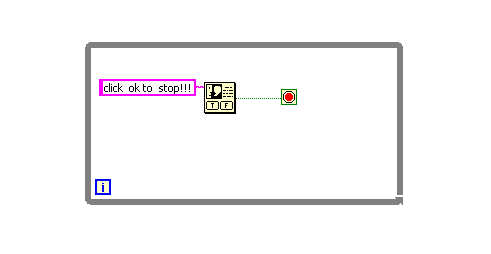

My idea as follows:
hope can stop the loop by the user defined event, but this event never be triggered. Please give an advise.

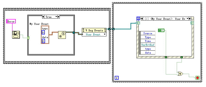

Hi David,
if you ask the user before the user event, then you can simply use a case structure.
To get the event, you have to generate the event. Use the "Generate User Event" function for it. You should create the event in any case. Decide only if you generate it or not. Don't forget to use the "Destroy User Event" function.

Hello Mike,
As your hint I make such a block diagram:
 But it  cannot find any defined data label I've defined from the event structure's terminal. Please give a support.

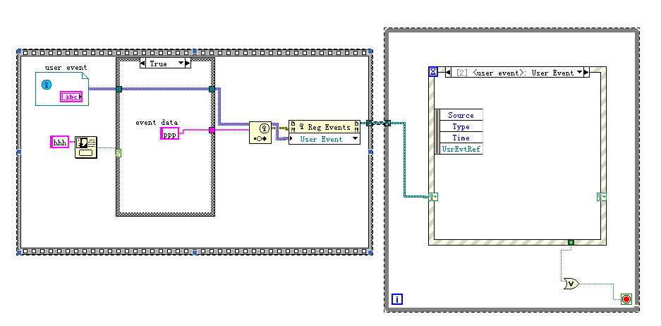

Hi DavidLee,
see the two possibilities to solve your problem.
Mike

Hi Mike,
That is what I need. Thankyou very much.
