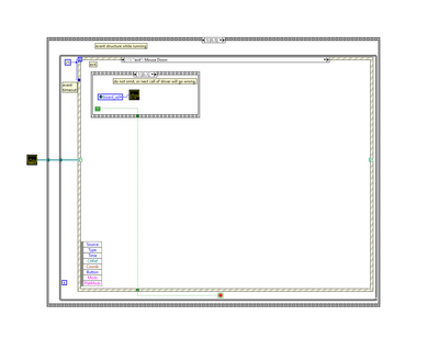

Thanks for your replies, I don't know the reason why the VI was written that way, I was hoping to make things work without having to substantially rewrite the vi, at least as a temporary measure until I write something that blends better with the rest of our equipment (being that Labview or python or C or whatever). Here's a couple of screenshots. I am also uploading the main vi itself but it is a bit complex (20+ sub-VIs in the folder) so it may take a long time to figure out every nook and cranny.
@Mark_Yedinak wrote:
If you have the source code for the application (which it sounds like you do) it may be easier to simply add a small TCP task which would generate user events into the existing code. However, without seeing the code it is impossible to say how feasible this would be. My thought would be that you simply create the necessary commands that you need to control and translate those to the appropriate events of the current application. It would most likely involve creating some user events which mirror specific events such as the mouse down.
This sounds more or less what I was thinking of doing I have uploaded some code. do you know where I can find information on this? As in there is a specific manual section I should look at? Thank you

Thanks for the VI. From the style of the front panel control and the overall program architecture, it seems like this was originally written 25+ years ago! Most likely whoever wrote this is long retired! 😄
Front panel: Almost everything from the classic palette, but there are a few modern element, most likely added during maintenance years later.
Block diagram: Topelevel stacked sequence structures with 16 frames is not somebody would even consider in modern times. Glaring race conditions!  Are all these globals really used globally or just locally? What about all these inner greedy loops? Value property nodes?
Yes, there is a lot of unmaintainable code out there. Sometimes companies hired summer interns or high school students to write a "LabVIEW driver" or demo code for their products and it shows. calling the dll in a reasonably simple program is all you need.
