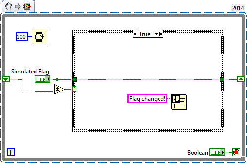

OpenG toolkit actually has a Boolean Trigger which may be useful. Here is a simple implementation with shift registers. I'll let you fine tune it if you only want it on the rising edge 🙂

Thanks a lot man! I didn't know about openg libraries, the boolean trigger over there saved me.
