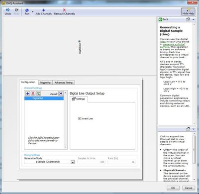

To do the same in Labview, I put two DAQ Assistants in flat sequence with 10 ms delay, each of which inverts the line as shown below (the VI is also attached).

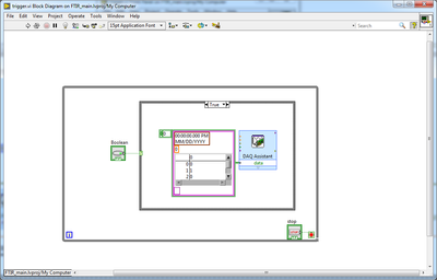

The picture of the code that you posted doesn't say anything except that you never set the Digital Output to anything, so you never turn anything on or off in this code.  Do you see the input marked "Data"?  Nothing is wired to it!!!  Thus its value never changes.

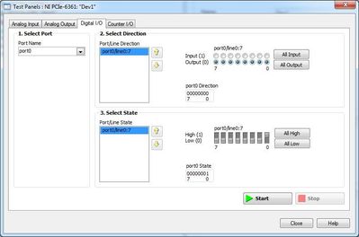

Yes I have used the Test Panels in MAX to turn on and off the digital line. Creating a task in MAX shows a different menu, what I see on the DAQ Assistant in Labview, so I end up with the same problem.

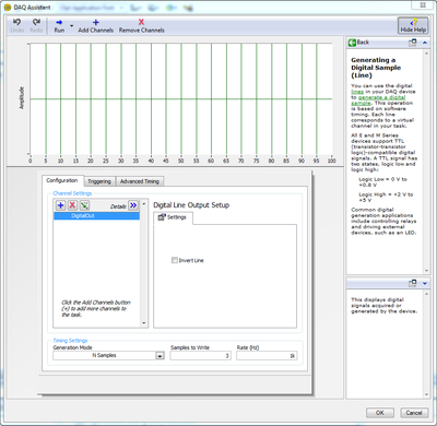

Following your suggestion, I added a waveform data to the DAQ Assistant, and it works!
Can you please take a look at the screen capture below and let me know if you have any further suggestions?
I'm still unsure whether this is a standard way to generate a trigger in Labview.
