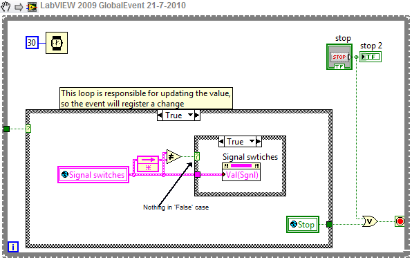

First things first.
Using 'Global' to communicate between VIs is not the best option.
However you can get you system to work by adapting your sub-vi according to this:
19547i343D6687127CFB2D
In your MainVI you should just place the Sub-vi. Don't us FP.Open, since that won't start the subVI.
Ton

I have modified your main and subvi to give you better architecture.  Instead of using globals, it is better to pass references to the subvi so that they can share the data space with the main vi.  Clicking on any referenced control on the main can cause an action in the subvi.  Also, instead of writing the value to a local or global in the subvi, you must write to the Value(signaling) property node in order to trigger an event.  In your main, you called the subvi dynamically, and then you called it implicitly.  Not desirable.  I changed your code to call it one, implicitly.  Study the modified vi's against your original ones.  You will see how references and Value(signaling) work.  Also, timing is important in that the timeout case in the event structure must be less than or equal to the Wait(ms) time in the lower loop.  If not, the lower loop will queue up events faster than the event structure can handle them and you will have problems.
You can delete your globals vi.  It isn't needed anymore.

This works perfectly, give this man some kudos.
I just hope I can integrate this into my main.
Works as standalone, works as a subvi.  PERFECT!
