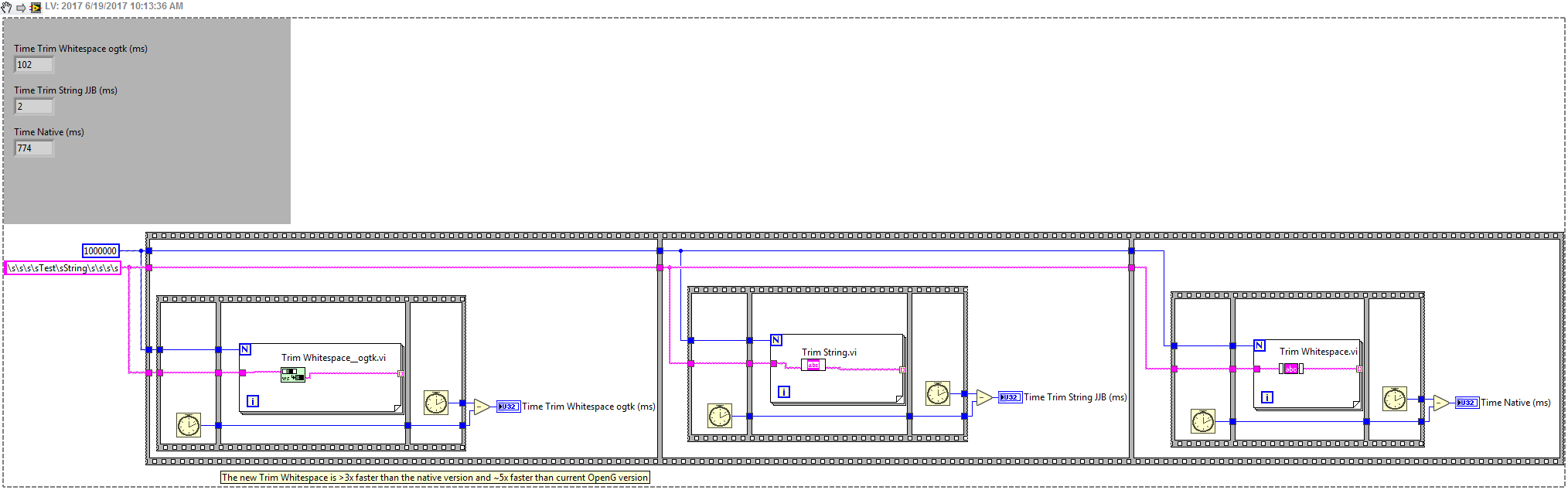

Just because you asked
I modified The test bench from the OpenG link

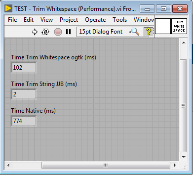

So, in the cases where you do not mind trimming more than whitespace,  Use Trim String
Let me make that FP shot a bit larger
In sth's use case (cleaning up VISA Strings) the result might be better anyway (Gets rid of control codes too)
Message 47 of 95

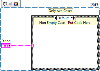

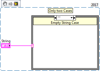

Ironically enough, I have having the same conversation, DrJ was there also, about the trim whitespace with respect to the JKI State machine on GitHub. I may have to try your solution. One thing that DrJ noticed was that if there is good chance of having an empty string, then having a case structure was much faster, this was true for the Match String Case. However the case structure needed to look like this, string wired directly to case structure:
Message 48 of 95

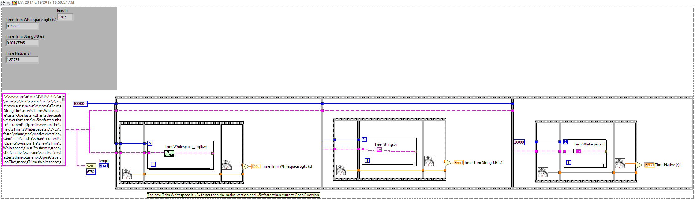

I was a bit worried about large string performance
NOTE: The native Trim Whitespace.vi just could not play with the others and I had to unload the loop count 1000:1 to make it finish in a reasonable time.  OGTK loses some performance as expected but Trim String.vi is essentially un-affected.  I suspect there is a very smart search in the Threshhold 1D array.
Message 50 of 95
