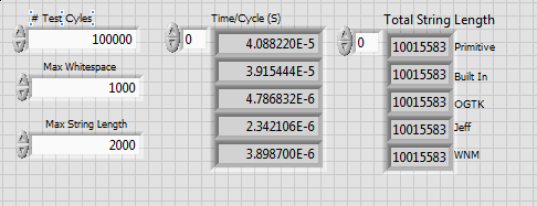

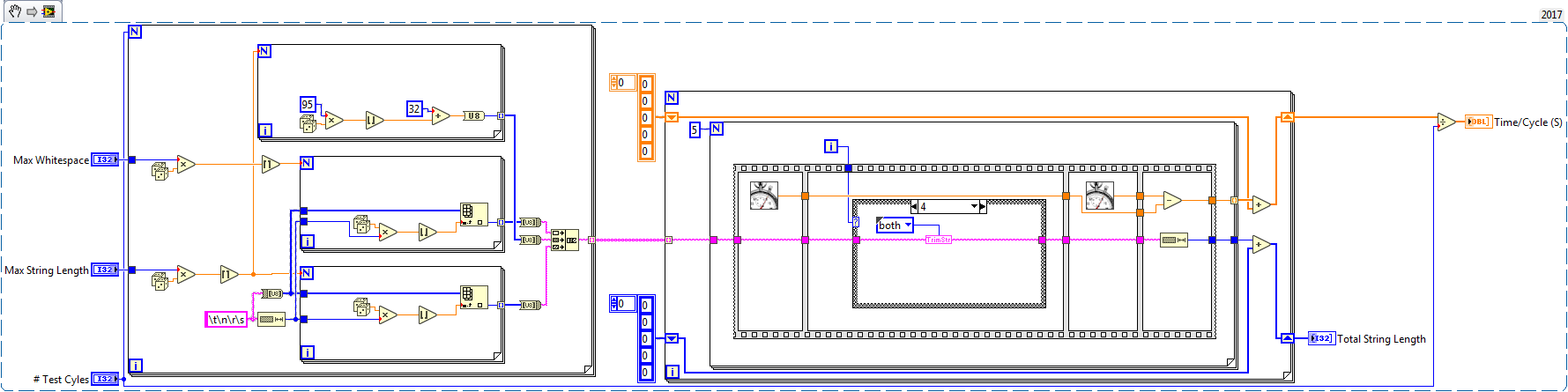

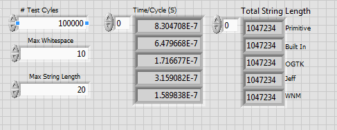

This is hopefully my last post on this topic, I have spent too much time pondering white spaces.
The last benchmark I did was with LabVIEW 2017 64 bit, Windows 7, 4-core Xenon processor. All Trim White Space subVIs were set to subroutine priority, debugging off in the calling VI.
I did not include the 2 modified OpenG VIs as one could get caught in an infinite loop and the other gave a different result with respect to the other VIs. For short strings, WNM's solution was the fastest.
For longer strings, Jeff's solution was the fastest
Note, there is some weird effects with regard to the order of the tests, that is, the times can change slightly. No idea why.
