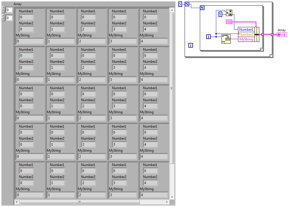

Hi Erik,
when your (1D) subarrays will be of different length you should use an array of cluster of 1D array...
(4,708 Views)
GerdW is right. Your best option is probably an array of clusters of 1D array of clusters.
The first thing to do, if you have not done so already, is to make a typedef of the inner cluster - the one with the actual data values.  The reason for making this a typedef is that if you ever need to change it, you only need to change the typedef and the changes will propagate through the entire project.
Next make a 1D array of the typedef cluster.  This will be the datatype for your varaible length arrays.
Put this array in a different cluster.  You now have a cluster containing an array of the typedef clusters.
Now make an array of this cluster.  This is your final array. This is a 1D array, the elements of which are the cluster containing the array. The nice thing about this for your application is that this final array thinks it contains clusters. It does not care that each element can be a cluster containing an array of a different length than the array in the cluster in a different element.
It is tricky to describe using words, but easy to implement in LV.
Even though you do not know the maximum size of the array, it is still much better to initialize the array and use Replace Array Subset.  You can probably estimate the maximum size based on how long the program will run, how fast elements will be added, or the maximum amount of memory you have available. After the protion of the program where elements are put into the array ends, remove the unused portion of the intialized array.
Lynn
