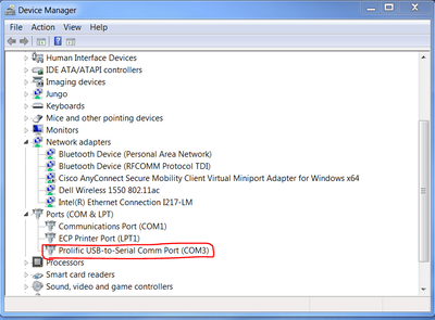

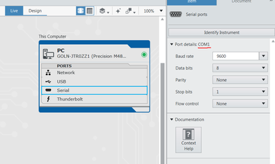

I'm using the usb to TTL interface from BK Precision and its connected to COM3 of my computer. It is visible on my device manager but on LabVIEW I cannot even view that communication port, only COM1 is available to edit its baud rate and such.

Post screenshot of your Device Manager.
Message 6 of 10
(4,900 Views)
Device Manager with COM3 connectionDevice Manager with COM3 connectionLabVIEW only COM1 availableLabVIEW only COM1 available

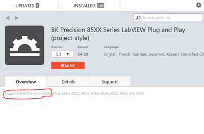

Also here is a screenshot of the driver I've installed

The only thing I can think of is that another program is using COM3 .
Message 9 of 10
(4,801 Views)
Hmm. I gave up. Switching to a bk8601 which has an actual usb port and it all works fine.
