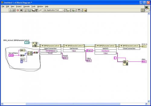

 Manufacture provides an ActiveX control to use in LabVIEW. One function "OpenConnection (ServerName: PChar; out Result: OleVariant) requires a Pascal PChar type; when accessed from LabVIEW, it is converted to String type. I tried to wire a normal LabVIEW string, it returned an error saying the ActiveX Server is not installed or registered. I manually registered the server, but it still returns the same error.
I tried to convert the LabVIEW string to a Pascal type, like shown in the picture (put the string length in the beginning and a NULL in the end to make it a null-terminated string), still the same error. My guess is that the problem still lies in the string, it is not compatible with the Pascal type. But how can I convert the string in this case?

Actually, there is no error message from LabVIEW. The error I referred to is the message from manufacture program.
The attached LabVIEW code runs fine until the last step which is trying to close the connection that never established.  The automation open is working well without error.

The first call to "OpenConnection" returns '-2' (no LabVIEW error), which means 'the ActiveX server' is not installed or registered. Then at closing, it returns a LabVIEW error saying "Catastrophic Failure", which I think is because the connection was never established in the first place.
So I still think it is the LabVIEW string is not compatible with the Pascal string, when I feed the name of the ActiveX server, although it looks to the right name, it is converted to a different pascal string. Then the program cannot find the proper server.
I don't think anything can be done from LabVIEW to fix it in this case.
