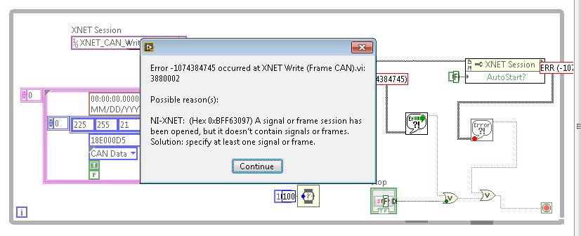

I am trying to get a simple XNET CAN write frame going. Here is the VI I created...
I keep getting this:
I looks like I have a frame set up, so what else could be the issue?

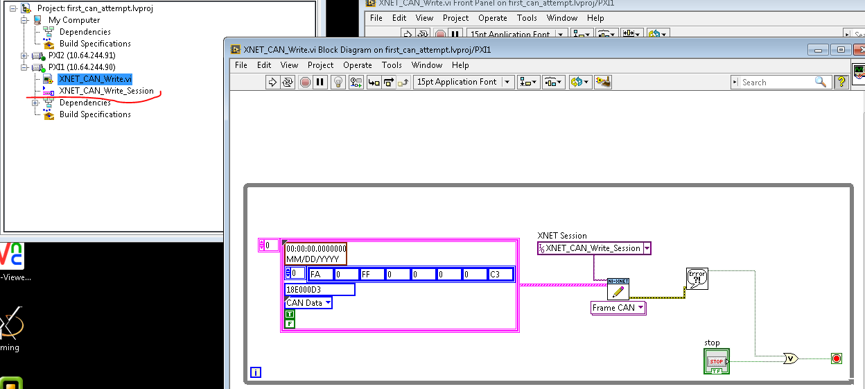

I am "trying" to create a session and send data on the fly. I changed my vi back to the simple one I had earlier in the day:
(4,887 Views)
I am trying open a session and send a message with the VI in the diagram, no DB. Is that possible. Open XNET session and just send an arbitrary CAN message?
(4,886 Views)
I create the XNET Session for a remote PXI machine:
(4,878 Views)
Can you show the configuration for your write session?
You do need to define which frames are in that session.
If you want to send arbitrary frames, I think you'll need to work with the in memory database to configure the frame prior to writing to it.

I got it to work. Had to specify a frame in the XNET configuration. So, yes I need the frame db stuff...
