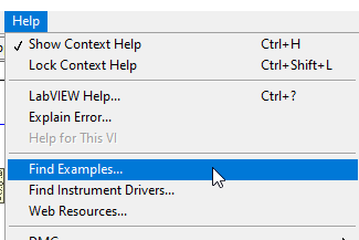

To make sure the card is working correctly without being affected by something else in your code, I would check out the DAQmx Examples included in LabVIEW.
Go to the Help, choose Find Examples and search DAQmx. Find the continuous input examples and test your card there. Once satisfied that it is working correctly, then start examining your code piece by piece. That is about the best I can offer without access to the code.
