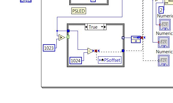

I have a true/false case structure.  True, I subtract a number, False goes straight through.  I only want to connect one output to both ture and false but I get a "wire connected to a undirecteded tunnel" error.  I know how to fix this when it is a numeric case structure by right clicking and selecting "use default if unwired", but there is no default for a true/false case structure.  Thankscase1.JPG

Hi PO,
no need to post twice!
- Why do you use two output tunnels in your case structure?
- Why don't you attach your VI or just a snippet of your code? Images are hard to debug with LabVIEW!
Two solutions without case structure:
General logic:
IF input > 1023 THEN
  output := input - 1024
ELSE
  output := input
ENDIF

From your attached sanpshot, you see one wire going out of the tunnel (from the subtract block) but there are two output tunnels on the case structure (one where the wire passes, and the other to the feedback node). Both these need to be wired. As a cheat, you can always wire a constant to one of them if that works. That should replicate the functionality of "use default if unwired"
(5,852 Views)
That worked, I see now that using a case structure for true and false is something I will try to avoid for an application like this.
