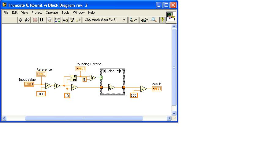

Figured it out.  See attached.  Not the most elegant solution but it serves the purpose.  The multipliers and divisors could be made into controls for more options for other circumstances which I will likely have to do on other projects forthcoming.
I would really like to see the basic mathmatical functions for truncating and rounding (with perhaps a option to select midpoint rounding direction) added to the program.  If MS can do it in Excel, then it should be a non issue for NI to do it.

dacad wrote:
The LV Round to Nearest Function does not play by standard rounding rules, instead, it rounds to the nearest EVEN integer.
As Jeff said, that is the IEEE standard.  If you want the "traditional" rounding, here's the hoops I had to go through.  Also keep in mind that this currently only works for positive numbers.
Again, you do NOT need to truncate first.

I do understand the IEEE rounding standard but that technique will not work for my situation.   It is also not what I consider standard street rounding. Granted, I've been out of school a few years but for basic mathematics, I was always taught that 5 rounds up and 4 rounds down.
This is why I state that 1.1049 rounds to 1.1.  Again, perhaps old school but the 9 round the 4 to a five, in turn rounding the 0 to a 1.
Crossrulz,, did more or less the same thing that you posted. The effect of rounding a dbl precision to an integer with the LV functions is essentially the same as truncating.  Just a different way to accomplish the desired outcome.
As a search on the great web will show, there are many methods of rounding available so it seems to be a matter of selecting which one suits the situation.
Interesting that something so seemingly simple could become so very convoluted.  I may have to strike up a conversation with our statistician guru
Appreciate the feedback on this.
Doug
The method of rounding that LabVIEW uses is called "banker's rounding" and creates a more statistcally "neutral" result - that is, if you have to do several rounds of calculations and roundings, it comes out statistically closer to the actual number, because you will round down as much as you will round up.  "Normal" rounding is biased towards the higher number.  That being said, everyone who codes in LabVIEW probably had to make a "round normal.vi" similar to the ones shown here to please various powers that be...
Did you know that .NET uses banker's rounding also?
