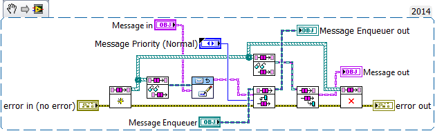

So I made a VI, it looks like this:
...which makes a response Q, packs it into a message as a Self Addressed Msg, Sends it to the Actor, and Waits for a Response on the Q.
On the Actor side I have my Do VI, which does some stuff and sends the results back via the self addressed message, or at least that's what I thought it would do.
The problem is, the priority queue DVR ref deep down in the message is Null upon entering this Do VI so my Send Synchronous Msg VI hangs waiting for a response which is never sent while the Actor shuts down per the default error handler.
Why is this reference going Null?  The VI that created it is still running waiting for a response so it shouldn't be an issue with it leaving memory I wouldn't think.
