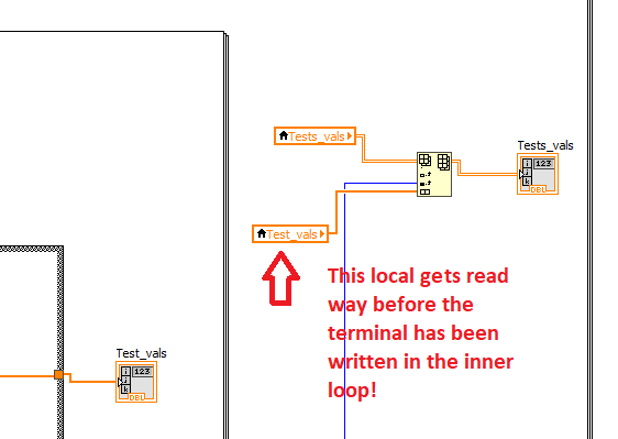

I am trying to insert a 1d array into a 2d array. outside of 1 for loop. I can see the 1d array filling with values. However, when I probe the "Test_vals" 1D array outside of the inner for loop I can't see anything.
I thought this might be something dumb that I'm not understanding because the 1d array is a local variable "so possible the indicator is not available outside of the first for loop?" However, when I put the indicator outside the first inner for loop (between the first and second for loops), which maybe could mean to define it there instead, I still can't read that 1d array variable.
A picture of what I'm talking about and the attached vi is below. Any help greatly appreciated!
Rick

@ricktrick26 wrote:
Can you please tell me the flaw in this thinking? I'm also unsure on how to read from an indicator without a local variable.
The data is in the wire, not in indicators! Indicators are to display information for the user, not to hold data for further use on the diagram.
  • None of your local variables are needed
  • Your outer FOR loop can never spin more than 2 times. Do you understand why?
  • Once you enforce proper dataflow using wires, your sequence structure is no longer needed.
  • Why is the index for the test_vals indicator set to 1921?
  • Why are most array controls/indicators set to show only one elements, but have the indices nonzero? resize for a reasonable view and show the scrollbars!
  • The lower left case structure only differs in one scalar value. the rest belongs outside the case structure
  • Here is one glaring race condition (picture) (and no, placing another sequence structure is NOT the correct solution!)
  • Why are there so many coercion dots???
  • Your error wired does not go into the shift register, but is wired on top of it.
  • Typically, "built array" is preferable to "insert into array" when appending.
  • Most of your logic makes no sense and is overly complicated.
  • It is significantly more memory efficient to append rows instead o columns. (appending columns requires significant rearrangement of most elements in memory). You can always transpose for display.
  • etc. etc. etc.
Do you have a simplified caller VI that has typical data wired? Do you have a description what the VI should do? I get the feelings that that entire task required only half a postcard worth of code (or less!)
(2,752 Views)

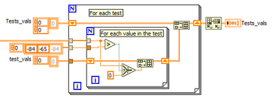

To point you in the right direction, here's a simplified version how your for loop stack would deal with the orange 1D and 2D arrays.
(I assume you want to start over with the test_vals" array for each iteration of the outer loop. It does not make sense to append longer and longer rows to the 2D array, each containing all previous data.)
